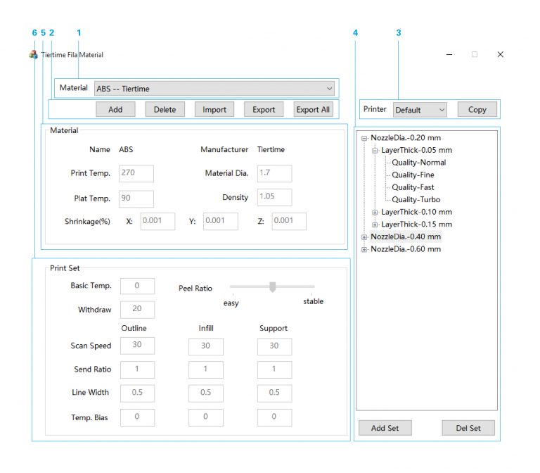

The following window is the main interface for the Material Profile Manager.
The interface includes several function areas which we will discuss one by one in details:
- Material Profile List
- Material Actions
- Printer Models
- Printer Settings
- Material Parameter Settings
- Print Parameter Settings

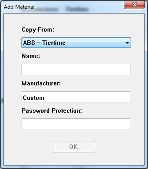

Add: Add a new profile.
A new profile needs to be created based on an existing profile, the default ones like the ABS, ABS+, PLA and TPU. All the existing profiles have all the values defined. When a new profile is created, it will inherit all the values from the base profiles.
When creating a new profile, user needs to choose a base profile, enter the name of the profile, and manufacturer’s name. In the end, a password is needed for the protection of the content of the profile from modification. The password can not be retrieved. If, in any case, the password is lost, you have to delete the profile, and create it again. You can leave the password blank as you choose so.

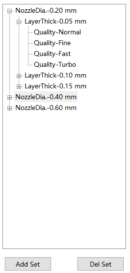

4. Printer Settings
All the printer settings are listed in this table based on the printer model. For example, UP mini 2 only support 0.4mm diameter, so for UP mini 2, the table only shows the entry of nozzle diameter 0.4mm, and no other nozzle settings will be shown for UP mini 2.
The table includes several levels: Nozzle Diameter, Layer Thickness, and Print Speed. Each entry in the table is a set of parameters which will be defined in the Material Parameter Settings, and Print Parameter Settings.

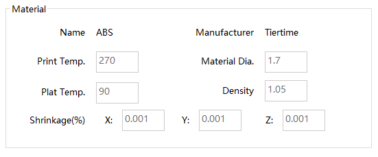

5. Material Parameter Settings
This area includes the material settings for filament. All the parameters here normally can be found in the filament brochure or the filament vendor’s website.
- Print Temperature (0 – 500ºC): This is the extruder temperature for filament extrusion and retraction only, not used for printing. The actual printing temperature is the “Basic Temperature” on section below.
- Material Diameter (mm): The diameter of the filament.
- Platform Temperature (0 – 200ºC): The bed temperature for printing.
- Density(mm/g): The density of a filament. This number is used by UP Studio to estimate the weight of material consumed by a print job.
- Shrinkage (0-5) %: These values on X, Y and Z axis refer to the shrinking happening while printing on X, Y, or Z axis. Some filament vendors provide these values. If can not get them from the vendor, leave them unchanged.

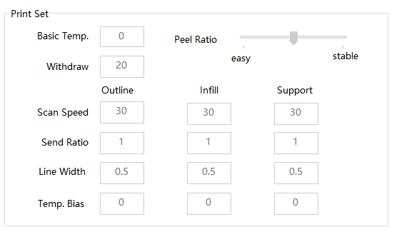

6. Print Parameter Settings
The following parameters in Print Parameter Settings are the settings for the printers, which are crucial for the print quality.
- Basic Temp (ºC) : This the actual nozzle temperature used for printing. This value could be different from the Print Temperature in the Material Parameter Settings. The “Basic Temperature” can only be set in range +/- 20ºC of “Print Temp”..
*Tips: The faster the print speed, or the smaller the nozzle size, the higher the printing temperature.
- Withdraw (mm): It’s the retraction length of a filament at a skipping point. The extruder retraction is needed to avoid oozing/dribbling. At a skipping point, the extruder stops extruding, but the melted filament is still dripping. In order to stop the dripping, the extruder needs to stop extruding, or retract the filament. The length of the retraction means how much the retraction is. The longer distance the retraction, the less the dribbling. It is not the longer the better, because long retraction distance could cause other problems.
*Tips: We recommend set the withdraw length to 20mm.
A printed model includes three different portions: Outline, Infill and Support. The following parameters are provided to set different values when printing at the different portions.
- Scan Speed(mm/s): The printing speed. You can specify different printing speed for the three different model portions.
- Send Ratio: The amount of filament extruded from the nozzle for printing. You can specify different extrusion amount for the three different model portions. This value is a ratio where 1 is the extrusion amount when printing outlines. If the ratio is less then 1, it means less filament is extruded.
- Line Width(mm): The line width when printing different portions of a model. In the UP Studio, you can specify the line width, but for all the lines for the model. Now you can tell the printer to act differently for the three portions.
- Temp Bias: Specify the different temperature when printing different portion of the model. The value can be plus or minus 10ºC from the Print Temp.
- Peel Ratio: Could be set in a value from 0 to 100. This slider allows you adjust the easiness of support and raft separation from the print. If the support is too tight to remove, you can make the value of Peel Ratio smaller by sliding the slider leftward.
In UP Studio, If the Easy Peel is checked, the Peel Ratio value is minus 20 from the peel ratio value with Easy Peel not being checked. If the Peel ratio is 20 or smaller then it will be reduce to 0 when Easy Peel is selected.
