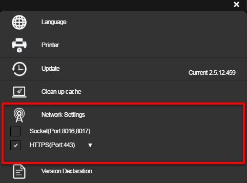

1.Go to Settings, select Network Settings, uncheck Socket, and check HTTPS
2. You can also set up the HTTPS Proxy.

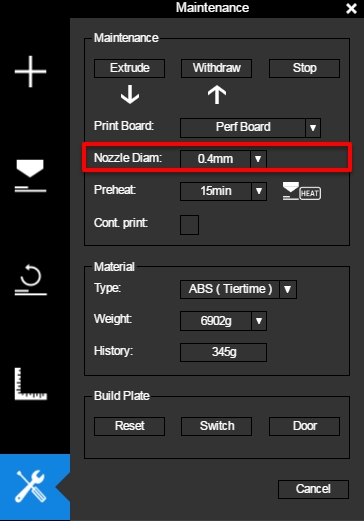

The Nozzle Diam options only open for BOX, BOX+, Cetus printer and some other brands coming up. For other printers, UP mini 2, UP mini 2 ES, UP Plus 2 and etc, the nozzle diameter is set to 0.4mm, and you can not change it.
The options for Layer Thickness can also be changed if the nozzle diam is changed. Check the Layer Thickness settings before starting a print.
How to change the nozzle diameter:
Open UP Studio software on your computer, click UP on the left side menu, click Maintenance, and then find Nozzle Diam to change the settings to the desired value.

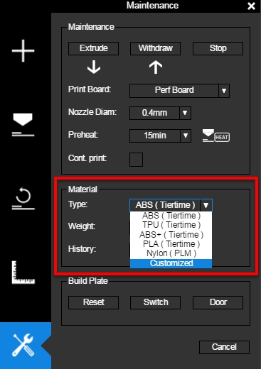

Different machines may use different build plates.
UP Plus 2, UP mini, UP mini 2, UP BOX and UP BOX+: Perf Board, and Flex Board
UP300: Perf Glass Board, and Flex Glass Board.
X5: Per Board.
After the nozzle height detection is done, a popup dialog allows user to choose from the available build plates, or click UP on the left side menu, click Maintenance, find Print Board to change the type to the desired value.

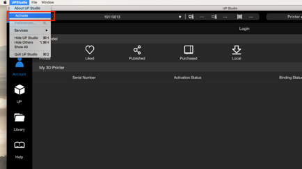

Go to https://www.tiertime.com/software/, find the LKD File for MAC V x.x.x.x.
Open UP Studio, choose Activate, and then load the LKD file.

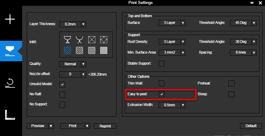

Normally, the nozzle height is a bit to close to the build plate. The model is pressed too hard onto the build plate, which makes the model hard to remove. Adjust the nozzle height, and make sure the height is correct.
You can close up a little bit of the extruder fan, so that the fan blows a bit less wind to the model.
- Software Adjustment:
Open UP Studio software, click UP, click Print Settings, click More, and then select Easy Peel.
- For software 2.5 and above
Use Material Profile Manager, and adjust the Peel Ratio to find the right value.
