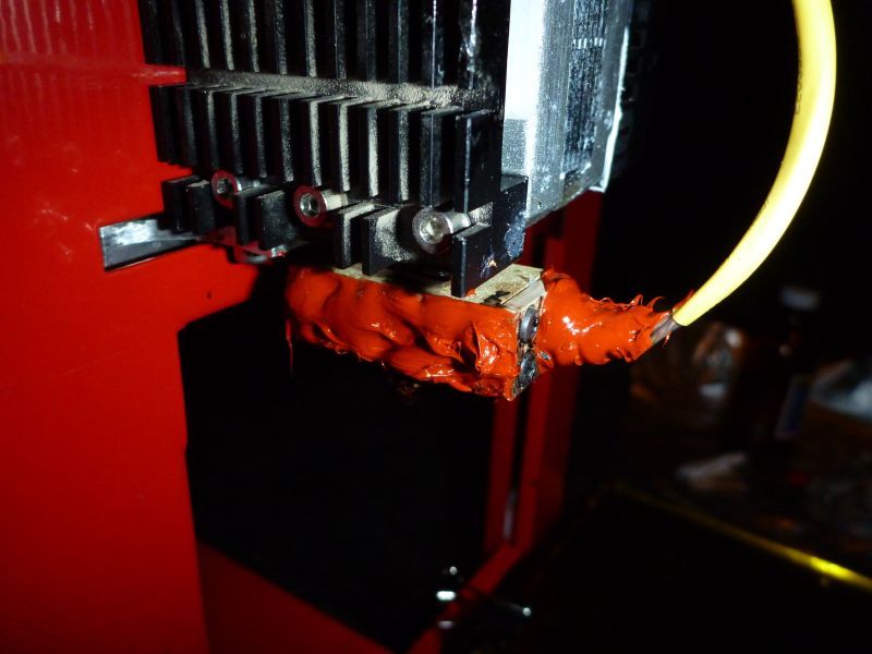

With the new wind barrier fully open I occasionally get a "nozzle too cold" error. So I decided to try coating the side of the heater that gets air blown on it with some high temp silicone. I also beefed up the heater wires to help give them some extra strength, as they are notorious for breaking.
So far so good. The temp now stays at 100% even with the flap fully open.

Thanks Julia. I've been meaning to try this for a while. Finally got around to buying a tube yesterday!
The other advantage to this is that filament doesn't stick to the hot end resulting in a lumpy smelly mess. ( You already have a lumpy mess of silicone!! :shock: :D )

Thanks for the info and picture. I wasn't aware of that. I guess just one more little improvement they are doing. Good to see its continually being revised.
One other major advantage of either the heat tape of silicone is that it becomes much harder to burn yourself too!

I was wondering what silicone you used. I have been looking at Sellys Engineering 401 Silicone but its only rated to 205C.

The silicone I used is ABRO RED. RTV Silicon gasket maker. Its good for 343C.
