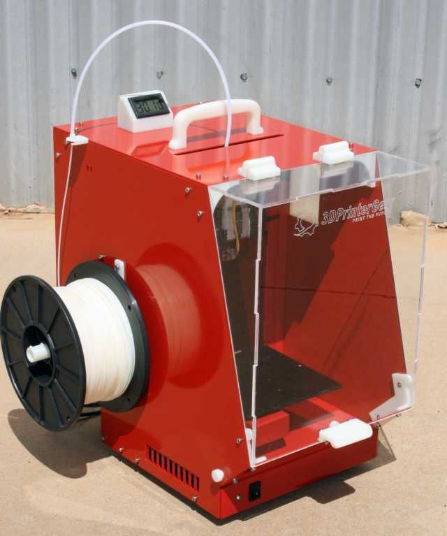

WARNING! Gratuitous self promotion ahead.
This also doesn't take up much bench space, knock things off your table or potentially over heat your electronics. It does however cost more.
Image[/URL]
These are now black though, not the red pictured and suit the Plus v2.
