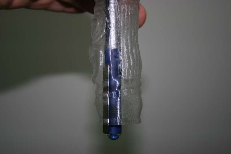

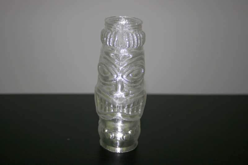

Here is a little sample of a print I did today. Done at .3mm and surface print option. Temperature reduced to 250. Although this is higher than the recommended temp of 212-230 it still printed really nicely. Also the raft removal has been really easy too, which surprised me.
T-Glase has a real lustre to it too which reminds me of sterling silver when it catches the light. Something I couldn't capture in the photos.
Its super transparent.

Wow, Jamie, that's awesome. Super-transparent indeed! Can't wait to get some.

That does look very transparent!
I can think of many things where transparency would be welcome.
