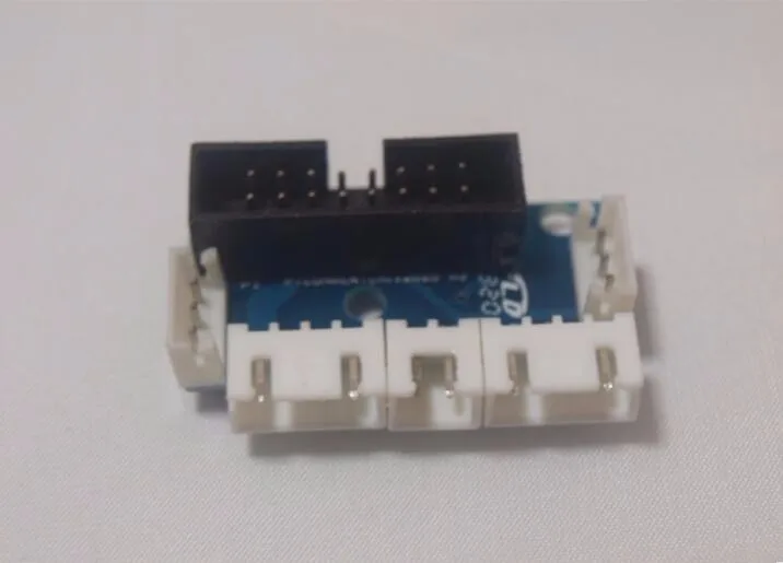

I've plan to mod the board for my up mini 2.
I just found on the aliexpress, there are adapter board for extruder. It's for UP! PP3DP TIERTIME 3D AFINIA.
Is it also compatible with UP Mini 2?
https://www.aliexpress.com/item/32834163766.html

no it is not .. that is board that goes to up plus 2 and similar printers, mini2 have different board on extruder ... that one might have same pinout for the imput but the position of the connectors is different on the one on mini2
Ok thank you. I thought it has same position of the connector with up mini 2. I've plan to change the board for up mini 2. If the connector is compatible, it would be simplify for the board connector

If you want to keep the extruder but replace the main board, maybe this could be a cheaper solution?
https://www.thingiverse.com/thing:3465278
(Its pictured at the hotend, but I made it for the other end, worked well for using with a Duet2Maestro in my up mini 2)
