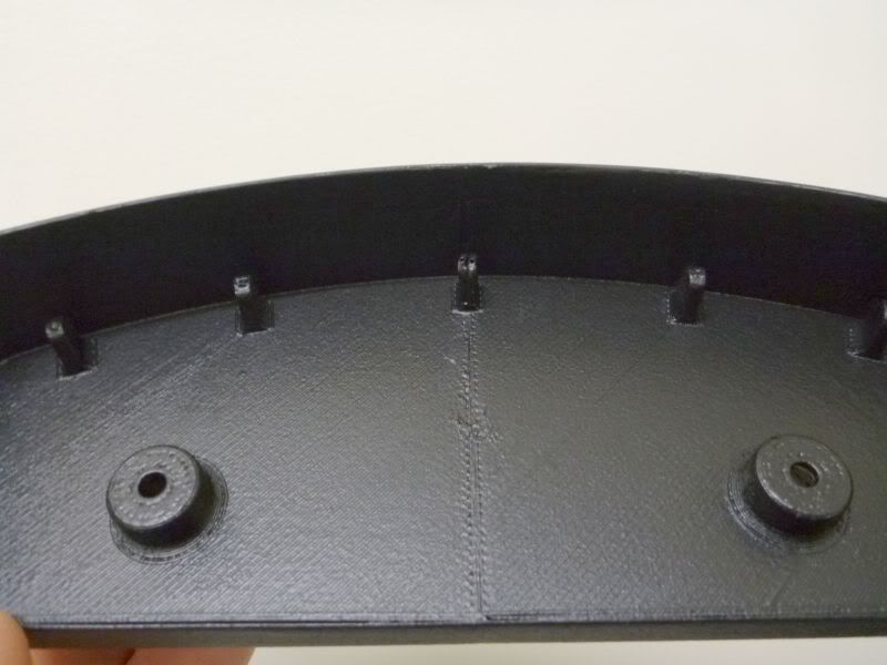

This is one side of a fridge light end cap I made. The length of the part is approx 180mm, so it was printed in two parts and welded together. I used a spray putty designed for plastics and then followed up with a bumper repair paint. I quite like the rough effect it gives, it is similar to the original part ( which I don't have sorry) and also does an excellent job of hiding any imperfections.
A look under the skirt, so to speak.

Fantastic-looking finish! What is "spray putty"? I think I need some...

Great surface finish. Do you know an Australian supplier of the spray putty, and hopefully the link to their site.

i use spray putty from supercheap auto. Doesa nice job.
Julia its basicallyan auto filler or putty that you can spray froma spray paint can. Itsa 'thick'paint

As smarterengineering has pointed out, I also got mine from an automotive store (Repco).
The product I used was made by Proform, called 1k high build primer/filler. Works great on plastic. You can then paint straight over it.

The end result looks great! The layers of the print don't show up at all. Did you sand the plastic prior to applying the primer/filler, or spray the primer first, and then sand that? Or no sanding at all? (Wishful thinking on the last option, but hoping it's that easy!)

HAHA yeah I wish it was that easy. No, I sanded with (400 grit) the parts first to get rid of most of the layers. Then let the spray filler do the rest.
You probably could spray over the layers, but it would take much more filler and lots of coats. In the end it would probably take less time to sand them.

SEM Products makes a really nice texture chip guard that will give the rigidity and the texture you're looking for. I've also had some really good success with their primers and plastic specific paints.
