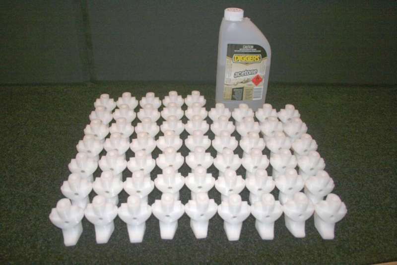

Here's a sample of what I have been printing in nylon. They are handles for air seeders.
